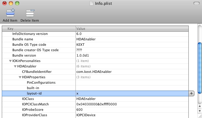

A vanilla AppleHDA.kext or a patched AppleHDA.kext must be installed into /System/Library/Extensions only.
Any legacy kext(s) and HDAEnabler.kext can be installed into /Extra/Extensions, /Extra/Extensions.mkext, or /System/Library/Extensions.

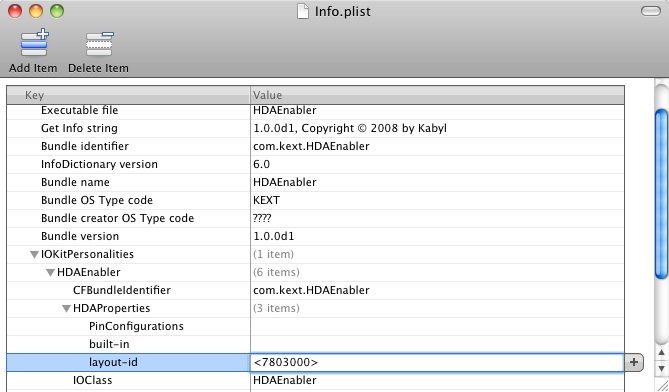

***If you are using DSDT.aml that has HDEF, you don't need such HDAEnabler.kext.***

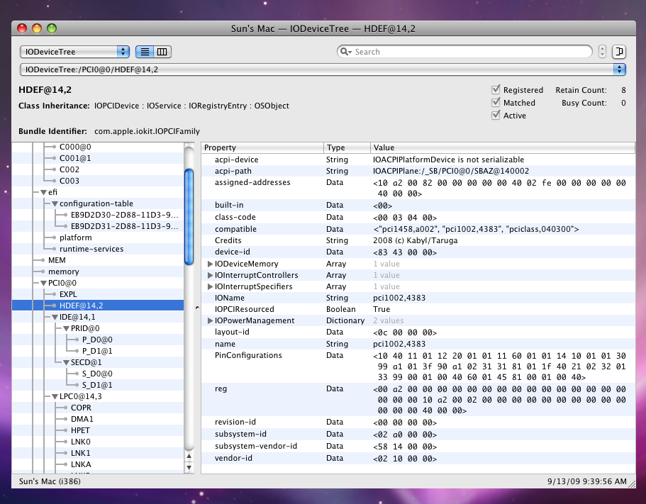

***layout-id in DSDT or HDAEnabler.kext must be matched to LayoutID in info.plists of LegacyHDA.kext or AppleHDA.kext.***

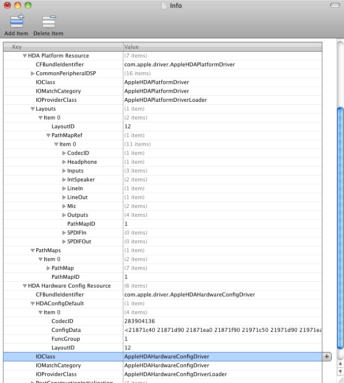

for ALC889A layout-id = 12 ; 0x0000000c ; 0x0c, 0x00, 0x00, 0x00

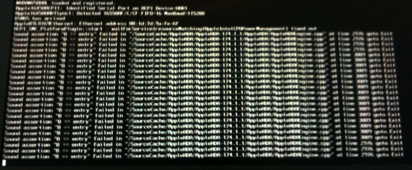

These following files have no front mic that causes of "Sound assertion "0 == fMikeyDriver" failed in "/SourceCache/AppleHDA/AppleHDA-162.1.37/AppleHDA/AppleHDADriver.cpp" at line 1063 goto handler."
Attached File  N1_1.6.2a37_3outs2ins_digital_HDA_headphone.zip ( 603.32K ) Number of downloads: 476
Attached File  N2_1.6.2a37_3outs2ins_digital_regular_headphone.zip ( 604.33K ) Number of downloads: 190
Attached File  N3_1.6.2a37_4outs2ins_analog_HDA_headphone.zip ( 603.05K ) Number of downloads: 323
Attached File  N4_1.6.2a37_4outs2ins_analog_regular_headphone.zip ( 604.09K ) Number of downloads: 245
(got from AlainTox714's thread)
