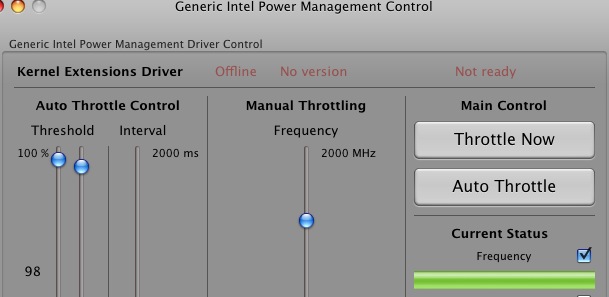

Hi, i loaded the newest .kext wirth success. (C2D 4400, EP35)
But the CPUMControl shows lock like below and it seems that no control is available.
Could you explain what the red text means ?
Must be something with my new board, i have now GA-EP35-DS3 and the ACPI of that.
Also the orig. 1.3.2 speedstep.kext didnt work anymore (using my old PSTATES).

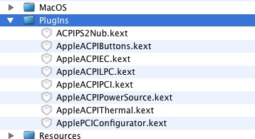

EDIT: I have in idea: I also installed (to change board) some new kext for that board (pcwiz).
Maybe thats the problem.
I remember i has an loaded ACPIThermal.kext or similar named - now not.
And also remember that thats essential for some tools.
Must be a .kext of the ACPIPlatform i think.
I will report that later.
I added my old AppleACPIPlatform.kext content and the newer/changed one .
There are much less plugins in the newer one !
Can someone tell me which are needed . All of them run well with old MSI-965P i dont know why pcwiz didnt included them.
I wrote an pm to pcwiz also, he is always very helpfull.

QUOTE (mitch_de @ Sep 2 2008, 05:00 PM) *
It means, that the kext didnt load. Try the debug version and look at the output in dmesg or system.log. The correct ACPIPlatform kext has only 3 plugins. The other plugins are from old versions. But this kext does not depend on any plugins of acpiplatform.

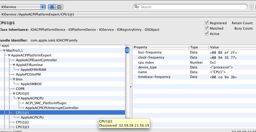

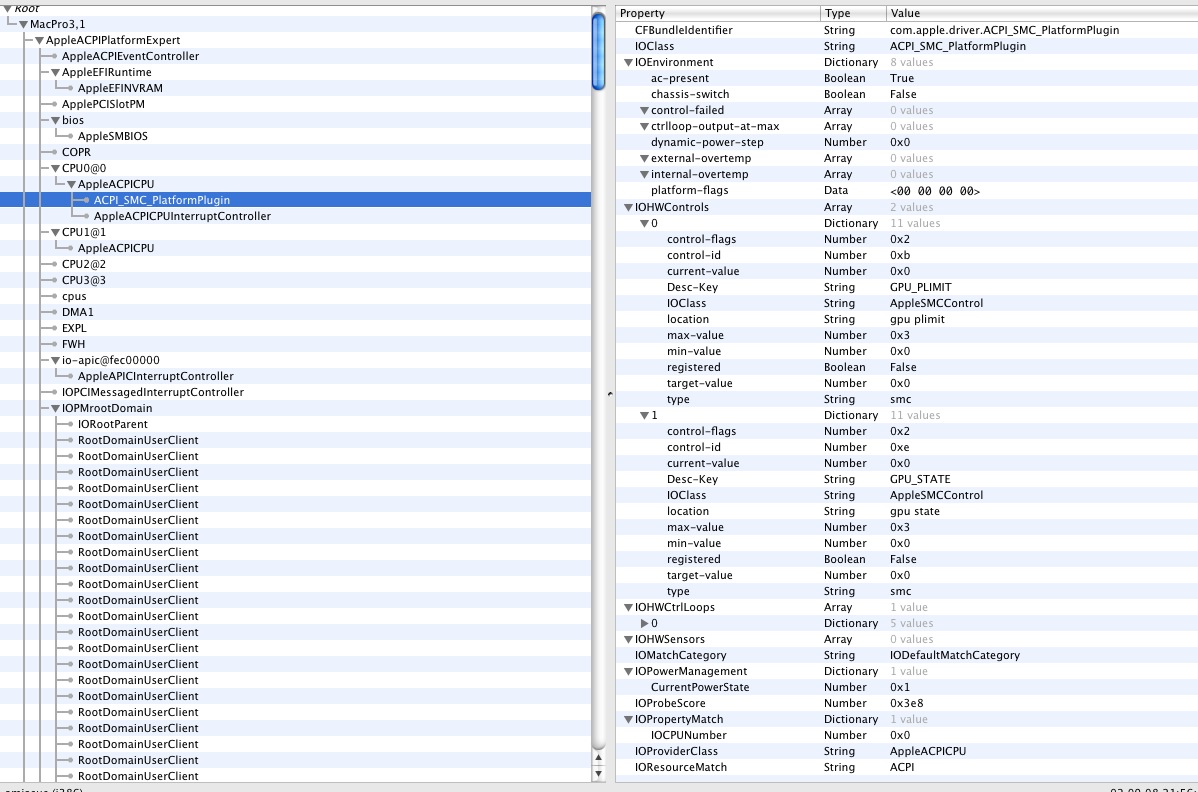

QUOTE (Superhai @ Sep 2 2008, 08:40 PM) *
OK:
GenericIntelCPUPowerManagement: Probing your system
GenericIntelCPUPowerManagement: CPU is Intel
GenericIntelCPUPowerManagement: Support for Enhanced Intel SpeedStep
GenericIntelCPUPowerManagement: Thermal CPU adjustment factor available
GenericIntelCPUPowerManagement: Thermal sensor available
GenericIntelCPUPowerManagement: Found I/O Kit CPU's at address 6f28580
GenericIntelCPUPowerManagement: Found I/O Kit CPU at address 3781880 CPU number 0 with name CPU0
GenericIntelCPUPowerManagement: Found I/O Kit CPU at address 3781700 CPU number 1 with name CPU1
GenericIntelCPUPowerManagement: Intel Core 2 Duo (Mobile)/Quad (Mobile)/Extreme/Pentium Dual-Core/Xeon (6 0Fh) (65nm)
GenericIntelCPUPowerManagement: CPU signature is 6f2
GenericIntelCPUPowerManagement: Thermal Junction Max is 100 C current temperature is 38 C
GenericIntelCPUPowerManagement: We have our device tree at 367f7c0
GenericIntelCPUPowerManagement: Found ACPI CPU's at address 3781f80
GenericIntelCPUPowerManagement: Found ACPI CPU at address 3781b80, CPU number 0 with name CPU0
GenericIntelCPUPowerManagement: Desktop GBT
GenericIntelCPUPowerManagement: We want to take control of Speedstep from BIOS, writing 34 to port b2
GenericIntelCPUPowerManagement: Error on ACPI read of CPU0, retrying (7)
GenericIntelCPUPowerManagement: Error on ACPI read of CPU0, retrying (6)
Unable to get P-States from your ACPI CPU
GenericIntelCPUPowerManagement: Found ACPI CPU at address 3780a80, CPU number 1 with name CPU1
GenericIntelCPUPowerManagement: Unable to get P-States from your ACPI CPU
GenericIntelCPUPowerManagement: Found ACPI CPU at address 3780a00, CPU number 2 with name CPU2
GenericIntelCPUPowerManagement: Found ACPI CPU at address 3780980, CPU number 3 with name CPU3
GenericIntelCPUPowerManagement: Mismatch between I/O Kit CPUs (2) and ACPI CPUs (4)
GenericIntelCPUPowerManagement: We didn't find useful P-State data for your CPU, we will now probe your system.
a bit confusing is that the terminal says:
bash-3.2# kextload GenericIntelCPUPowerManagement.kextkextload
: GenericIntelCPUPowerManagement.kext loaded successfully
Which parts (.kexts) can be ACPI depended (SMSBIOS.kexts also ?!) ?
I also added IOREGISTRY output screensoout (CPU1 less ACPI entry, but that was ever i can think, also with the old board)
Also i remember i had always (3 diff boards 4 CPU entrys in ACPI, 2 with values (0-1, OK my C2D 2 Kernels, 2+3 not). No problems wink.gif
EDIT: Even if kext is NOT loaded - try kextloading it makes CPU run at slowest PSTATE - not controlable - half results in geekbench.
Also HW Monitor shows that MHZ drop.
