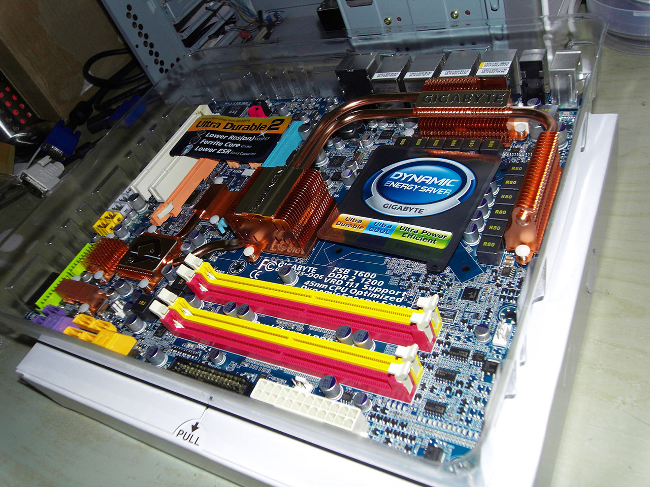

fresh out of the box with PCIe2.0, ICH10, ...

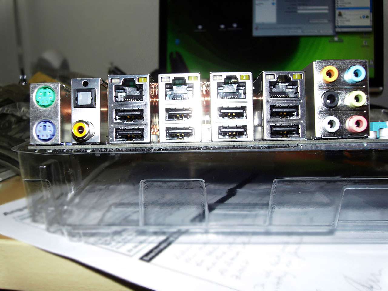

the bank of 4 seperate RTL 8111C GigabitNICs

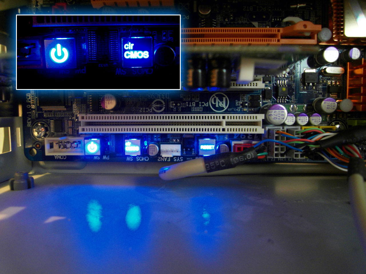

3 relatively useless but nice looking buttons on the bottom end of the mainboard.
The GA-EP45-DQ6 has many led indicators for several board functions & resources as AHCI-state, percentual CPU-load, etc.
Useless to me but surely nice for anyone in casemodding or under-table-disco ;-)
