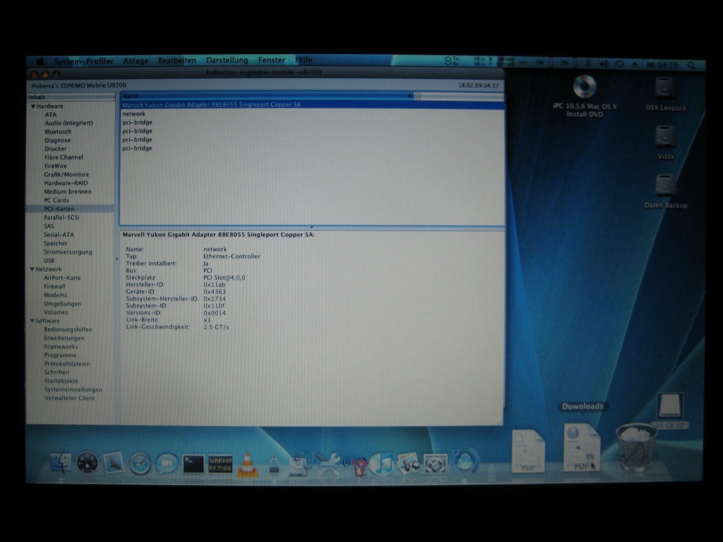

I only had to edit the info list per your instructions with 10.5.5 (10.5.5 Ideneb) and Sony VGN-FW160D which uses the Marvell 88e8055. Thanks so much. Now if I can get the wifi and hd3470 working properly. The experiment continues. biggrin.gif

Thanks a lot... It's recognized and I'm connected to the internet :-)
But one thing was curious... MAC told me, that this was my AirPort ;-) Renamed to Ethernet - just for the eyes!
THANKS AGAIN!!!!!

THANK YOU. This worked for me too... Ethernet down, wireless and audio to go. For the record, I have Fujistu C1410 with Vista and Kalyway 10.5.2 Dual boot.

I'm using a Sony FW160D with 10.5.5 Kalyway. I did the editting of the AppleYukon2.kext file and changed the id of the 88E8053 to 88E8055 and delete the orginal 88E8055 section. reset the permissions and rebooted. Works great.
